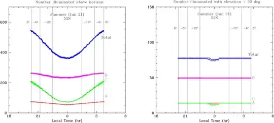

Number of Starlinks visible in the night sky to everyday people: more than 100 starlink satellites will be visible to us when we look at the sky after sunset and before morning.
enter image description here (ref)
You know how distracting moving lights are, If you look at a sleeping city with thousands of little lights, and 100 planes are flying over the city, it's confusing, you have to look away. The dawn and dusk will soon consist of looking at hundreds of low flying satellites when the first stars start showing up. 1-2 hours after sunset there will still be 20-50 obvious lights still visible, you'll have to look towards the dark side of the sky to only see higher satellites.
Hale bopp, shoemeker-levy, various exoplanets, galaxies and solar system events were discovered by hobby astronomers, and just two terrestrial telescopes on their own have found 5700 asteroids, comets, variable stars and other stellar object (Pan Starrs).
The research states 0.01 starlink lights per square degree, 1-3% of photos for narrow field telescopes will messed up at dawn/dusk, and maximum 30-40% of photos for a wide field 1 billion telescope being currently built.
