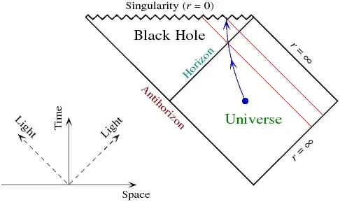

No. I think this is best seen from the Penrose diagram of Schwarzschild spacetime:
Penrose diagram of Schwarazschild spacetime, modified from one by A.Hamilton
Light rays run diagonally. In blue is an example infalling trajectory, not necessarily freely falling. Note the two events where it crosses the horizon and where it reaches the singularity. Shown in red are inward light rays that intersect those events. Thus, the events that the infalling observer can see of the external universe consist of the region between those light rays and the horizon. The events occurring after that won't be seen because the the observer will have already reached the singularity by then.
Now suppose the observer tries a different trajectory after crossing the horizon, accelerating outward as much as possible in order to see more of the future history of the external universe. This will only work up to a point: the best the observer can do is hug the outgoing light ray (diagonally from lower-left to upper-right) as much as possible... but since the observer is not actually allowed to go at the speed of light, seeing all of the future of history will be impossible. The best the observer can do is to meet the singularity a bit more on the right of the diagram.
By the way, since the light ray worldlines have zero proper time, trying to do that will actually shorten the the observer's lifespan. If you're in a Schwarzschild black hole, you would live longer if you don't struggle to get out.
The above is for an eternal, non-evaporating black hole, as that's what you're asking about here. (The 'antihorizon' is there because the full Schwarzschild spacetime is actually an eternal black hole and its mirror image, a white hole in a mirror 'anti-verse', which not shown on this diagram. That's unphysical, but not relevant to the situation we're considering here.)
