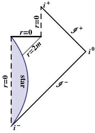

Here's a Penrose diagram of a spherically collapsing star forming a black hole that subsequently evaporates:
Penrose diagram of an evaporating black hole
Light rays run diagonally at ±45° on the diagram. Note that there is a region from which outgoing light rays (running diagonally lower-left to upper-right) don't escape and instead meet the $r = 0$ singularity (the bolded, undashed horizontal line). The horizon itself is the the $r = 2m$ line marked on the diagram and its extension into the star: it should actually go from the (dashed, vertical) $r = 0$ line on the left, rather than extending from the star's collapsing surface. That's because some of the (idealized, noninteracting) light rays from inside the star will also fail to escape to infinity.
Now suppose that on this diagram you draw timelike curves that stubbornly stay away from the horizon, and you insist on using a parameter along them as a time coordinate. Does the fact that you've chosen coordinates that exclude the horizon needs to be made consistent with whether or not the event horizon actually exist? The resolution is simple: if you want to talk about the horizon, stop using coordinates that exclude it.
