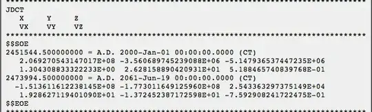

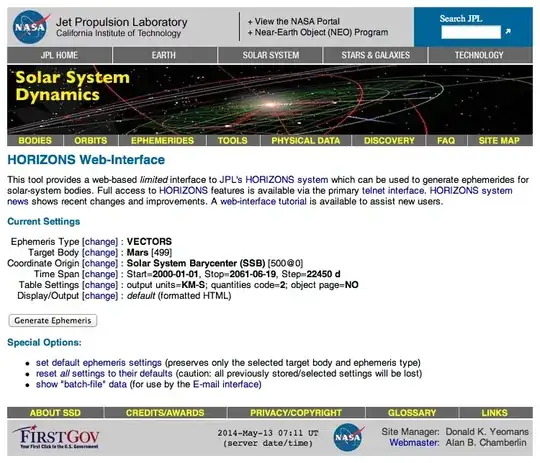

Horizons Ephemeris generator can give you a planet's position and velocity vectors at a specified time.
This is one set of possible options:
Clicking Generate Ephemeris on that page will give you position and velocity vectors:
Above the position and velocity vectors are the Julian date as well as the more conventional date.
