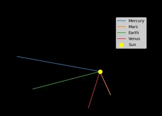

I am relatively new to astronomical programming and I am trying to code a simulation of the solar system as simplified as possible on python. To do so, I am using numpy in order to have one array containing in each row the x,y,z coordinates of position of each celestial body. So if N=5 bodies, the positions matrix will be sized (5,3). The initial positions and velocities of the bodies are uploading with the Spiceypy library (SPICE ephemeris). Then, I'm integrating using the leapfrog method. However, my code seems to run well until I plot the resulting positions: I keep on obtaining straight lines instead of elliptical orbits...
I am definitely doing something wrong, but I don't know what. Do you know what I am missing here? I suspect the problem is in the leapfrog integration.
Thank you for any kind of help you can provide!
Here is my code:

mkvb_78
    First guess is to make sure all of your units are correct. This sort of result is common when the force of gravity far exceeds the initial velocities. – Greg Miller May 02 '22 at 11:57
  • In addition, numerical stability is much easier if you use AU-solar mass-years units, instead of SI units. For example, in these units G=4pi. – James K May 02 '22 at 16:01
  • finally, for testing purposes, it would be convenient to break the dependency on spice and de440 (as these are large file dependencies.) You are only using them to initialise the system. So I'd suggest working out the initial values for may 2022 and hard coding them into the program. When everything is working with the hard-coded values, you can easily switch back the de400 values. – James K May 02 '22 at 16:45
    Why do you have G = 6.67430e-11*1e-9. Where does that extra *1e-9 come from? Everything else seems to be in mks units but this value. Unrelatedly, I'd suggest you post your code on something like code review. I think you could really benefit from someone reviewing your code from a coding perspective (aside from the science perspective you're asking for here). – zephyr May 02 '22 at 17:06
  • Straight lines intersecting the Sun mean that gravity is too strong or speed is too low. A quick way to check is to calculate the reduced kinetic and potential energies $v^2/2$ and $-GM_{Sun}/r^2$ and see if the kinetic is about half of the absolute value of the potential energy since a bound orbit will have negative total energy. Next, if the lines radiate away from the Sun then you might be missing a minus sign somewhere. Also be extremely careful to never mix kilograms and seconds with kilometers, use only meters (perhaps the 1E-09 zephyr mentions comes from that?) – uhoh May 03 '22 at 00:05
  • Finally, back up and first see if your method can solve a very familiar one-body problem. In a much shorter, simpler script, just put the Earth at $1.5 \times10^{11} \ \mathbf{\hat{x}}$ meters with a velocity of $2.9780 \times10^4 \ \mathbf{\hat{y}}$ meters per second, and confirm it goes around the $\mathbf{\hat{z}}$ axis in roughly a circle and takes about a year to do so. All that said, here's a complicated n-body script that matches a JPL ephemeris pretty well https://space.stackexchange.com/a/23409/12102 – uhoh May 03 '22 at 00:16
  • fyi "one-body" means just calculate for the Earth and leave the Sun's central force at the origin. Once you get the integrator working and generating real, physical results, then work your way up slowly; add several bodies without interactions (n x 1-body) then finally add back all the $n(n-1$ two-body interactions i.e. n-body. – uhoh May 03 '22 at 00:27
  • Since you're doing the calculations yourself, you might want to look at https://astronomy.stackexchange.com/questions/2416/where-can-i-find-a-set-of-data-of-the-initial-conditions-of-our-solar-system/13491#13491 and perhaps https://astronomy.stackexchange.com/questions/13488 (under "If you want to compute star/planet positions yourself, you have several options") – Barry Carter May 05 '22 at 14:05
  • Hi everyone, I can't thank you enough for all your suggestions and help. I manage to solve the problem by following the steps you described and by taking into account all your replies. – mkvb_78 May 30 '22 at 13:12
