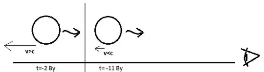

Does the fact that universe is currently expanding at an accelerating rate means that far far away objects (FAO) might start disappearing with time, set aside the "red shift"?
I'm saying this because from what I understand until now:
  • we receive photons from FAO that were emitted long long ago
  • now due to space expansion, some of those objects are now moving away at speed greater than the speed of light, but at the time the photons we receive today were emitted, these FAO where not moving away faster than light
So there must be a point in time at which these far away objects disappear from view. How is this concept called?, or is it only a mistake I'm doing in my thinking?
Here's a simple drawing to illustrate:
  • at t=-11 billion years(By), photons are emitted in a slow expanding universe, and today we can view the object as it was
  • at t=-2 By, the object moves faster than speed of light, so photon emitted at that time will never reach us, even if we wait the 9 by + "expansion correction" needed...
light from fast receding objects will never reach us
I couldn't be convinced by the answer I found here, saying nothing disappears out of horizon. I don't see how it complies with that answer were event horizon approaches us.

It is a common misconception that galaxies receding faster than light cannot be observed. There are two versions of this misconception:
  1. Galaxies that are now receding faster than light cannot be seen.
  2. If we observe a galaxy today, it may recede faster than light now, but when it emitted the light we see now, it did not.
Both are incorrect.

  • Now I start getting it... Light we receive from GN-z11 has ~traveled far more than 11Gly before reaching us... so it looks like light traveled quicker. I think I got my misconception from books where they were exploring theory where universe dominated by phantom energy(with an equation of state with $w$ < -1... – J. Chomel Feb 01 '17 at 10:17
  • @pela, what does this spacetime diagram would look like with $w$ < -1? – J. Chomel Feb 01 '17 at 11:03
    @J.Chomel: Well, the distance to GN-z11 today is 32.2 Gly (or 10 Gpc). The distance when the light that we see today was emitted was 32.2 Gly / (1+z) = 2.7 Gly. Although the distance to GN-z11 has thus increased by (32.2-2.7) Gly = 29.5 Gly during its journey, part of this is not due to light propagating, but due to expansion. The total path that the light "by itself" has traveled is given by the time it took, divided by the speed of light, i.e. 13.4 Gyr / c = 13.4 Gly. – pela Feb 01 '17 at 11:12
  • Regarding a w < -1 plot, I can make one at some point, but I don't have the time now. I'm not used to thinking about w < -1 so I would have to think, but I suppose since the plot is in comoving coordinates, the 45º lines would still be 45º, but the dashed purple lines would be more skewed toward to upper corners. Hmm… don't take this too seriously, I'm not quite sure right now… – pela Feb 01 '17 at 11:17
    Now I start getting it... Light we receive from GN-z11 has ~traveled far more before reaching us than the distance it was from us at the time that light was emitted (2.7Gly) ... so it looks like light traveled quicker.
    – J. Chomel Feb 01 '17 at 12:35
  • @J.Chomel Yes, exactly! – pela Feb 01 '17 at 13:38
