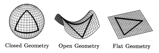

Three possible solutions
It turns out that, for these assumptions, there are three possible solutions to the Friedmann equation. We call the three possible universes flat, positively curved (or "closed"), and negatively curved (or "open"). Which of these possible universes we live in, turns out to depend upon the average density in the Universe, so by measuring this, we can determine the "geometry" of our own Universe. And it seems that it's "flat".
A flat universe
The reason it's called flat is that the geometry is like that of a flat 2D table, only in 3D. That is, a triangle has 180º, parallel lines never meet, etc. And it's infinitely large. Intuitively, we'd think that this is the way the Universe is, and definitely on small scales (say within our own Galaxy), it's an adequate approximation. In the 2D analogy, the 2D surface of Earth seems flat locally, and for all practical purposes the parking lot outside is flat. But if you draw a triangle from Congo→Indonesia→the North Pole→Congo, you'd measure it's sum of angles to be roughly 270º. That's because the geometry of the surface of Earth is not flat, but is "closed".
A closed universe
If the Universe were "closed", it's geometry would, in the 2D analogy, correspond to that of the surface of a ball, i.e. a triangle has more than 180º, lines that start out being parallel will at some point meet, etc. But like the surface area of a ball is finite (but doesn't have a border), so is the Universe. So if you take you spaceship and fly straight away from Earth, you would end up back here (assuming the Universe doesn't collapse before you get back, or expand too fast for you).
An open universe
If it were "open", it's geometry would, in the 2D analogy, correspond to that of the surface of a saddle, i.e. a triangle has less than 180º, lines that start out being parallel will diverge, etc. And it's infinitely large.
This picture from here visualizes the 2D analogies.
geo
In 3D, only a flat geometry can be pictured, and this doesn't look "flat" by any means; it is simply your good old 3D ("Euclidian") space that you know from your everyday senses.
