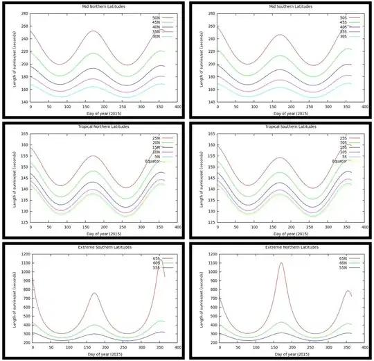

As noted in http://aa.quae.nl/en/antwoorden/zonpositie.html#14 the length of sunrise/sunset varies from approximately 128/cos(latitude) seconds at the equinoxes to approximately 142/cos(1.14*latitude) at the solstices.
More specifically, here's the length of sunrise/sunset at various latitudes:
Beyond 65 degrees north or south latitude, the sun does not rise or set daily, and the length of sunrise/sunset increases significantly.
The data plotted above is the length of sunrise, but the length of sunset is very similar.

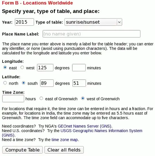

You can verify these results at: http://aa.usno.navy.mil/data/docs/RS_OneYear.php
The longest sunrise I found for 2015 was at 89 degrees 51 minutes south latitude, 125 degrees east longitude. There, the sun starts rising 20 Sep 2015 at 2352, bobbles up and down a bit (but never quite sets), and finally finishes rising 43 hours and 21 minutes later, at 22 Sep 2015 at 1913, but see caveat at the end of this answer.
You can "verify" this by first visiting http://aa.usno.navy.mil/data/docs/RS_OneYear.php with these parameters:
to get:

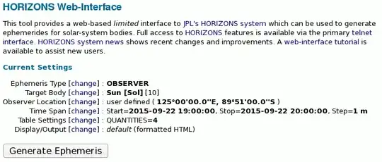

Verifying the end time is a little tricker. To do this, visit http://ssd.jpl.nasa.gov/horizons.cgi with the following parameters:
to get:

The sun's angular diameter is about 32 arcminutes, so the sun's lower limb is 16 arcminutes below the sun's center. When the center of the sun has geometric elevation -18 arcminutes (-0.3 degrees), the lower limb has geometric elevation -34 arcminutes. Since refraction near the horizon is also 34 arcminutes, the sun's lower limb rises when the sun's geometric elevation is -0.3 degrees.
In the table above, this occurs between 1914 and 1915, but my program uses slightly more accurate data for the sun's angular diameter, and the sun actually finishes rising between 1913 and 1914 (and closer to 1913).
You can then fly almost halfway across the world to latitude 89 degrees 51 minutes and longitude -19 degrees to see the one-minute-shorter longest sunset, which starts at 23 Sep 2015 at 2128 and ends at 25 Sep 2015 at 1648, a length of 43 hours and 20 minutes.
In this case, you would use http://aa.usno.navy.mil/data/docs/RS_OneYear.php to verify the ending time of the sunset, and HORIZONS to verify the start time of the sunset.
Polar sunrises and sunsets are considerably shorter:
  • At the North Pole, the sun starts rising at 18 Mar 2015 at 2015, and finishes rising at 20 Mar 2015 at 0441, a length of 32 hours and 26 minutes.
  • At the South Pole, the sun starts setting at 21 Mar 2015 at 1650, and finishes setting at 23 Mar 2015 at 0117, a length of 32 hours and 27 minutes.
  • At the South Pole, the sun starts rising at 21 Sep 2015 at 0508, and finishes rising at 22 Sep 2015 at 1400, a length of 32 hours and 52 minutes.
  • At the North Pole, the sun starts setting at 24 Sep 2015 at 0243, and finishes setting at 25 Sep 2015 at 1131, a length of 32 hours and 48 minutes.
Main caveat: Like HORIZONS and the sunrise/sunset tables above, I assume 34 arcminutes of refraction at the horizon. That's reasonable for most locations, but may be unreasonable close the pole, where the longest sunrises and sunsets occur. In particular, refraction can change rapidly at these latitudes, allowing for potentially much longer sunrises and sunsets.
