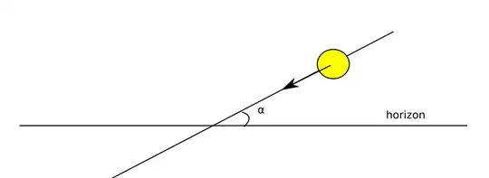

@Calc-You-Later's answer is correct in places where the path of the Sun is perpendicular to the horizon (at the equator during the equinoxes, somewhere between the tropics the rest of the time). There, the sunset lasts 2 minutes. However, at other latitudes, the sunset may last a bit longer.
Let $\alpha$ be the angle the path of the Sun makes with the horizon. This angle depends on your latitude and the date.
The speed of the Sun along its path is $\vec{v_s} = $ 0.25°/min. This speed can be projected along the vertical and horizontal axes. The vertical speed is now $\vec{v_s} . \sin (\alpha)$. The sunset length is still the apparent angle of the Sun divided by the vertical speed of the Sun.
So at higher latitudes, if the Sun sets, for instance, at a 45° angle, then the sunset will last 2 min / sin(45°) = 2.85 minutes = 2 minutes 51 seconds. If the Sun sets with a 60° angle, the sunset will last 4 minutes.
To get the value of $\alpha$, you can add your latitude and the solar declination:
- Determine how many days have passed since December 21st (i.e since the winter solstice). Let's call this number $x$
- Multiply this number by the amount of turning the Earth does in one day $ y = x * 360/365.25$
- Get the cosine of this number and multiply it by the tilt of the Earth $z = -23.5 * cos(y)$. This is the solar declination
- Add the latitude $\theta$ of your location $\alpha = z + \theta $
This does not account for atmospheric effects. The atmosphere will bend the rays of light, and can make it possible to see the Sun even though it is under the horizon.
The atmospheric effects, however, depend on the atmospheric conditions (temperature gradient,...), and are more difficult to quantify.

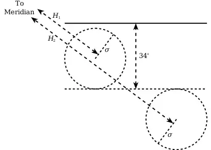

Now let's account for atmospheric refraction and the eccentricity of Earth's orbit. Not knowing air pressure and temperature, it's standard to assume that points appearing on the horizon are refracted upward by 34'. Let $\sigma$ be the Sun's apparent angular radius (15.7' at aphelion, 16.3' at perihelion). The geometric hour angles where the Sun's lower and upper limbs appear to cross the horizon are
$$ H_1, H_2 = \cos^{-1} \frac{\sin(-34' \pm \sigma) - \sin \varphi \sin \delta}{\cos \varphi \cos \delta} \tag{2} $$
Then
$$ \Delta t = (240~\mathrm{s}/^{\circ}) (H_2 - H_1) $$
Here is a table of sunset duration (mm:ss) at various latitudes on day 15.0 (UT) of each month in 2020, using equation (2). For latitudes between 60°N and 50°S, approximation (1) is within 3% of these values.

The dotted circles show the Sun's geometric positions when its refracted positions are as in the first figure. Let $h$ be the geometric altitude of the center of the Sun. Meeus §13 gives
$$ \sin h = \sin \varphi \sin \delta + \cos \varphi \cos \delta \cos H $$
Then
$$ \cos H = \frac{\sin h - \sin \varphi \sin \delta}{\cos \varphi \cos \delta} $$
and we can substitute $ h = -34' \pm \sigma $ to get equation (2).
