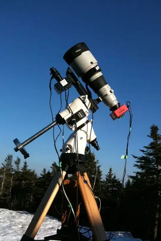

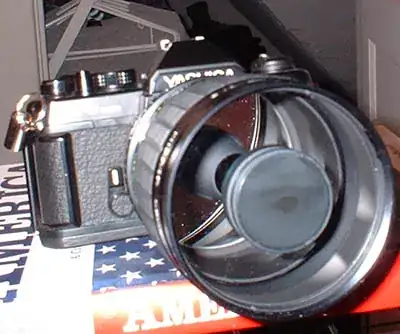

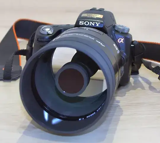

Yes, there is no hard distinction between a telescope and a camera with a long focal-length lens.
When it's stuck directly to a camera body, it's often referred to as a "mirror lens" because they still want to call it a "camera lens" but it's made from a mirror:
But when it's stuck directly to a tripod and the camera body is stuck to it, we call it a telescope. You can point it at terrestrial or extraterrestrial things, it doesn't make a difference.

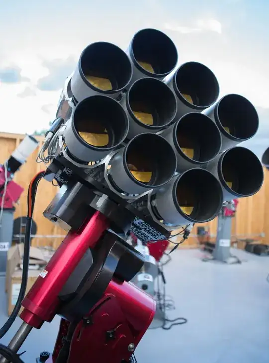

"Telescope? Camera?"
above x2: image of a Dragonfly refractive array telescope [from dunlap.utoronto.ca][http://www.dunlap.utoronto.ca/instrumentation/dragonfly/]. Image: P. Van Dokkum; R. Abraham; J. Brodie Images borrowed from What (actually) is the “ deprojected half-light radius” of this almost-all-dark-matter Galaxy?
