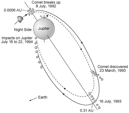

A very well documented example of a small celestial object with a gas giant is the collision between Comet Shoemaker-Levy 9 with Jupiter. As it was a comet that was tracked, the whole process of the collision was well documented and observed.
Though the collision occurred in July, 1994 - the first effects occurred 2 years earlier, according to the NASA Technical Report "Shoemaker-Levy 9 and the tidal disruption of comets", when the
break-up of Periodic Comet Shoemaker-Levy 9 into multiple pieces following its grazing encounter with Jupiter
This represents one of the first stages of the collision that could occur as the celestial object approached the large planet. In this case, this breakup resulted in Comet Shoemaker-Levy 9 to form a train of fragments to eventually collide into Jupiter - the full process at this stage is shown in the diagram below:
Image Source: Tufts University
