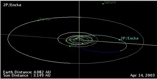

  • Some comets do have orbits on the ecliptic, particularly some short-period comets, such as Comet Encke:
Same image source as above
