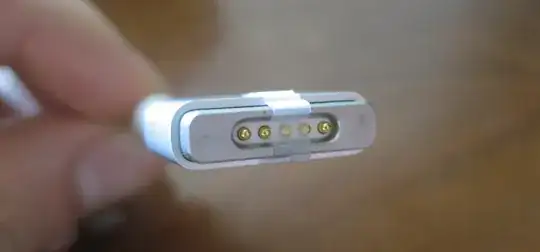

If you use a small piece of tape to block the middle (signal) pin on your MagSafe charger, your Mac will not charge because it can't identify the charger.

    If you remove the charger it also won't change. – CousinCocaine Jun 04 '14 at 18:50
    Of course, but OP wanted to know how to disable charging "even though your Apple portable is plugged into AC power." – Kevin Chen Jun 04 '14 at 21:58
    I confirm, this works. I am able to stay at 40% charge forever while using AC power, which is exactly what OP wanted, albeit the solution is not software but hardware :) I have Magsafe 2 – Sergei Jun 10 '14 at 22:02
    As the days go by, I can see the percentage slowly drop due to self-discharge. This is awesome solution for MacBooks used as servers, or MacBooks used as desktops. This answer deserves more upvotes! – Sergei Jun 21 '14 at 08:44
    Yep! On laptops whose CPUs have higher TDPs, you might notice that the battery level also drops when you make the computer work hard and the charger can't provide all the power needed. – Kevin Chen Jun 22 '14 at 13:55
    I used this to make my MacBook work with an underpowered car inverter so it would draw less power and it worked great. Thanks! – Justin Cherniak Jul 11 '14 at 23:21
    So it does not charge the battery, but it does use the power for normal consumption. Nice solution! – CousinCocaine Sep 30 '14 at 12:35
    This is gold. I wish I knew this right after I started using my laptop. Many thanks for the tip! – WhatHiFi Jul 05 '17 at 18:20
  • Careful with this. Worked for months, then it smoked a charged almost damaged my mac and started a fire. Charger tip melted and burnt the charging port where the MagSafe connects. I used transparent tape like the photo. Maybe I should have used electrical tape. But, I think a timer like yurkennis suggest is safer. – Skurfur Apr 12 '21 at 12:04
  • can anyone test this with the new magsafe 3? – anonymousaga Feb 05 '22 at 21:16
