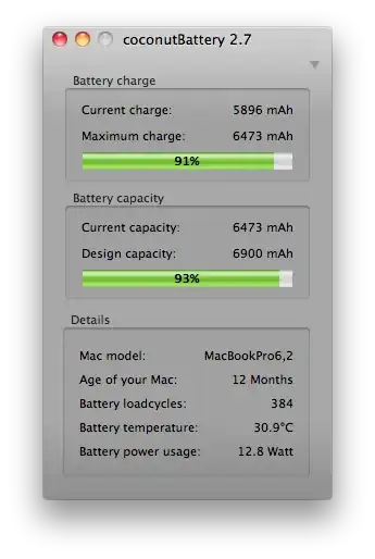

As a comparison to Harv's answer, I frequently drain my battery. As you can see from the screenshots, we have the same model computer of about the same age, but I have more than 3x the cycles. I leave my laptop plugged in at night, but it is unplugged most of the day while I use it. I get the battery below 20% almost every day, and occasionally multiple times in one day. Even with the extreme differences in usage, our batteries have nearly identical capacities. Mine holds slightly more, but it is possible that he got his computer before I did and has been using it longer. Through a comparison of the two data points, it seems that options 1 and 2 are both valid.
Note: Harv is closer to 10 cycles per month than the 1 specified by option 1. I assumed that the significant usage difference is enough to prove the concept. It would be better if we could get a data point with closer to 20 cycles.

I keep it plugged in as close to 100% of the time as I can. See a screenshot of my battery status, and note that it's a year old now.
App used: https://www.coconut-flavour.com/coconutbattery/
