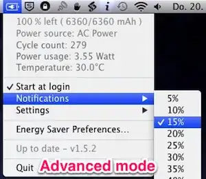

SlimBatteryMonitor
Not only does it save much more space in your menu bar, it lets you choose what information to show in specific states.
I have mine set to show the time when running on battery, the percentage when charging, and just the icon when fully charged.
asmeurer
  • 1,995
  • This works in Mountain Lion! Awesome. – gentmatt Jul 27 '12 at 06:26
  • This is exactly what I was going to recommend. You can even make the icon "disappear" when the battery is fully charged (it doesn't really disappear, but there's just a very tiny sliver of it left and it's the same color as the menu bar so it isn't distracting. – TJ Luoma Jul 31 '12 at 18:32
  • Impressively, this app continues to work even with Yosemite, even though the developer hasn't updated it since 2009. You'll need to adjust the default warning panel percentage with newer laptops, as 15% charge lasts a lot longer than it used to. You can even adjust the colors so that it works in Yosemite dark mode. – asmeurer Nov 14 '14 at 16:53
