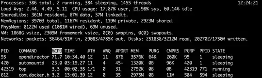

After the update the process opendirectoryd is constantly using about 70% of cpu.

After killing the process it appears again. I've searched /var/log/*.log, but I haven't found any errors that can help fix this problem.
It looks like that I have found a way to fix it.
I've edited /etc/auto_master, commented out the line starting with /home and then executed sudo automount -vc.
