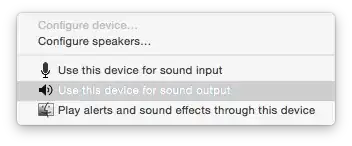

Go to /Applications/Utilities and open Audio MIDI Setup. Select the device you want to use, click the gear, and then Use this device for sound output.

  • It's a virgin installation of high Sierra, albeit cloned from another drive. there is no third party sound drivers/devices. the default behavior for Mac OS is to stay on the selected sound device on reboot. this is all I want. – Eweie Sep 15 '19 at 21:59
  • @Eweie what happened when you tried the above? You can do the same thing, just choose whichever sound device you want. – dxdc Sep 15 '19 at 22:02
  • does not work and is not different than just selecting the device form the dropdown. – Eweie Sep 20 '19 at 08:16
