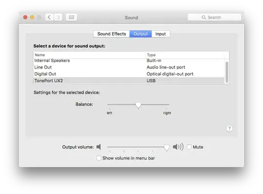

Maybe a little pictorial clarification - using the above script with outputA = 3 & outputB = 4, I can now switch between Digital Out & TonePort UX2.
One more note - the line numbers do not have to be consecutive, I could just as easily switch between Internal Speakers & TonePort by using lines 1 & 4.
