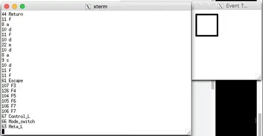

There is a utility you can use that can verify if the keyboard is sending the code or not - xev. You'll need to run it in XQuartz which is an X11 environment.
Using the following command, you can get the output of each keypress
xev | grep -A2 --line-buffered '^KeyRelease' \
| sed -n '/keycode /s/^.*keycode \([0-9]*\).* (.*, \(.*\)).*$/\1 \2/p'
Below is some random keypresses on my wired Unix keyboard attached to my Mac. xev sample output XQuartz
I've used this to test and map Sun Microsystems Type 5, 6, and 7 keyboards on my Mac and can verify that it detected the extra keys. If xev can see it, it means that the scancode is being sent, it's just the HID kexts macOS uses are insufficient.

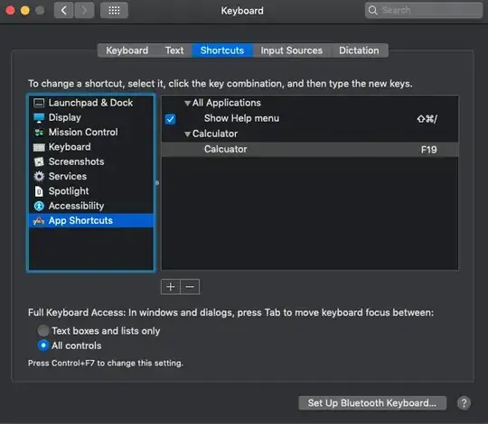

It's been 9 months since Cobberboy posted a solution. It worked nearly perfect for me in 10.14.3 Mojave, but it only worked when the window focus was on Finder. To fix this, add an "App Shortcut" in the Keyboard Shortcuts menu (look at cobberboy's last photo on the left hand menu) and add a shortcut for all applications.

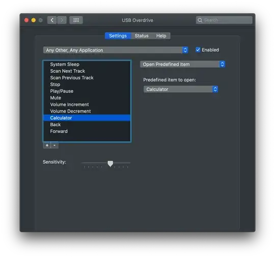

I have a Ducky-brand keyboard with a “calc” button, and I was having the same problem. I found that the shareware app “USB Overdrive” can remap it to launch a calculator or do any other action. It also explains why the other keyboard mappers don’t get the keypress - USB Overdrive registers it as a mouse click event, but apparently whatever mouse click number that is, it’s common enough that the app already knew it was named “calculator”.
jes5199
  • 131
Building on what @jes5199 discovered I also installed 'USB Overdrive'. It's essentially a rebinder for non-keyboard devices, e.g. mice. Installation requires a reboot, after which it appears as a system preferences panel. Pressing the calculator button revealed the preconfigured setting, and once I closed the panel it worked without any additional setup. USB Overdrive
I couldn't get Karabiner EventViewer to recognize either a keypress or mouseclick for the calculator button. Tested before and after installing USB Overdrive. Overdrive did manage to remap it to system Calculator without fuss, so I'm happy.

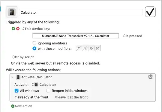

You can also use Keyboard Maestro with a "USB Device Key" trigger (a normal Hot Key trigger is not enough):
It's paid software, but to me it was worth every penny because it does a lot more than this.
