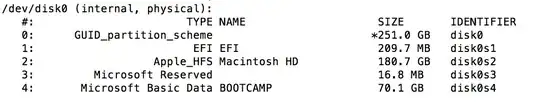

The output from diskutil list disk0 is given below.
/dev/disk0 (internal, physical):
   #:                       TYPE NAME                    SIZE       IDENTIFIER
   0:      GUID_partition_scheme                        *256.0 GB   disk0
   1:                        EFI EFI                     209.7 MB   disk0s1
   2:                  Apple_HFS Macintosh HD            180.7 GB   disk0s2
   3:         Microsoft Reserved                         16.8 MB    disk0s3
   4:       Microsoft Basic Data BOOTCAMP                70.1 GB    disk0s4

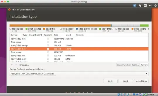

  5. Select the partition shown below. This partition should be the same size as previously specified for the Swap partition when the diskutil resize volume command was entered.
    61
  6. Click on "Change..." and select "swap area" in the popup window as shown below. Do not change the partition size. Next, click on "OK".
    62
  7. Select the partition shown below. Next, click on the "-" to delete this partition.
    63
  8. Select the free space as shown below.
    64
  9. Click on the "+" to open a "Create partition" popup window. Select "EFI System Partition". Also, change the size to 500 MB and click on the "End of this space" button. Next, click on "OK".
    65

Install Ubuntu. Insert the Ubuntu flash drive and restart the Mac. Hold down the option key to invoke the Startup Manager. Select to boot from the USB flash drive.
