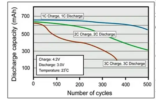

Figure 2 from BU-401a: Fast and Ultra-fast Chargers graphically shows deterioration in long term battery life. Note deterioration in charge holding capacity and life of battery are both affected adversely
Figure 2: Cycle performance of Li-ion with 1C, 2C and 3C charge and discharge Charging and discharging Li-ion above 1C reduces service life. Use a slower charge and discharge if possible. This rule applies to most batteries.
Bottom Line: Use fast charging when you "have to" due to time constraints else if possible stick to normal charging if you care for your battery( if you have read this lengthy answer, it's because you care:). But a relevant question is what can be done if your cell is equipped only with a fast charger? Answer would be to use a battery pack for normal use and fast charging when you really need it. This way, you could end up spending more but wouldn't need to bother about battery health
