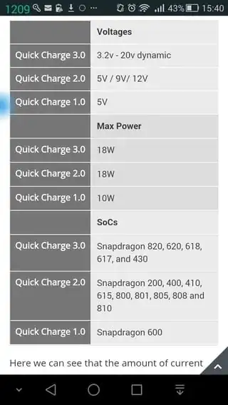

  1. Qualcomm Quick Charge 2.0 supported four modes at varying power levels, 5 volts/2amps, 9V/2A, 12V/1.67A, and a 20 volt option
  2. Qualcomm Quick Charge 3.0 has major new feature INOV (Intelligent Negotiation for Optimum Voltage), which allows for
  • A fine tuned power output and a more optimized charging cycle. Quick Charge 3.0’s INOV communicates with the device to request any voltage between 3.2V and 20V at 200mV increments, allowing for a wider selection of voltages
  • INOV has the added benefit of being able to dynamically adjust the charging voltage over the battery charging cycle
( Linked source has a video explaining this and graphical comparison is pasted in the section at end of answer )
  1. This granular variation of voltage to control power , results in
  • 27% faster charging than Quick Charge 2.0 (2x faster than the original Quick Charge 1.0) while
  • Reducing power dissipation by 45%
  • Increasing power efficiency by 38%, and being friendlier to the battery life cycle.
  • You're looking at 4 times faster charging compared to regular charging, and devices capable of jumping from 0% to 80% in about 35 minutes.
To summarise, granular fine control on voltage and in turn on power supplied for charging is the key innovation that results in these improved figures. Qualcomm Quick Charge 2.0 had only one voltage level relevant to mobile devices- 5V, whereas Qualcomm Quick Charge 3.0 has 9 variations possible from 3.2V to 5V in steps of 200 mV. This granularity offers tight control on power delivered for charging in a dynamic manner as required
