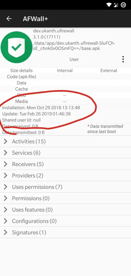

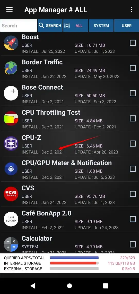

There are many third-party apps which shows the install and update time of the installed apps. I've tested three of them and have given instructions to use them for the task at hand.
App Manager
Install it → tap on three dots line in upper-right area → Sort → Last update.
If you click on an app entry there you can also see its Installer name in the App Info (scroll down to the bottom) section.
Applications Info
Install and launch the app → tap your app's entry.

(Click an image to enlarge it; order of images: Applications Info, and Solid Explorer)
