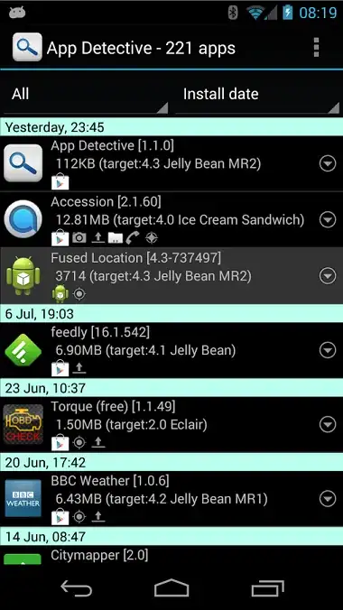

There are several apps to use, but I like using App Detective.
It's easy, concise, and fully detailed. This will tell installation time plus a lot more.
screenshot

  • Thanks @Andrew for pic edit, for some reason earlier wrong screenshot got uploaded when posting – HasH_BrowN Mar 11 '15 at 06:34

  • Thanks. App detective is the best. It was able to determine the date of installation of all apps even the apps installed prior to the installation of app detectives –  Jun 16 '16 at 00:02
