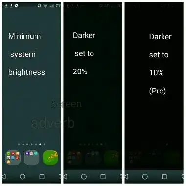

Try using an app called Screen filter. CAUTION: Do not set the brightness below 17 because you cant see anything. You can text at nighy n the person sitting next to you wont even see
Disclaimer: Not tested on Lollipop as my device is NOT on Lollipop, my device doesn't brighten up screen on full charge. Would request OP or Samsung S4 galaxy users to confirm. Theoretically should work
Firelord in his solution has highlighted a point that my earlier solution entails that the screen is lit for milli seconds that could possibly cause a disturbance to OP. However, his method involves rooting and identifying the file to change the maximum brightness levels
IMO, this approach lacks universality, since it is applicable to those who are rooted and have the understanding to identify the file to change brightness levels (technical merit apart). Hence, I am presenting an alternate solution which provides similar results but without rooting
This involves using a screen filter app Darker. This is available in free version (which can reduce brightness to 20%) and Pro Version (which can reduce brightness to below 20%, down to zero brightness). App description relevant here says
Darker can lower your screen brightness to extremely low levels, to help prevent eyestrain during the night
Macro Logic:
  • Activate the Darker app whenever power to charge is connected to decrease screen brightness to a comfortable level
  • When charger is manually disconnected on waking up , tap the stop button of the app to revert to normal brightness (from notification panel)
  • If there is a need to answer a call or text message, either manually do the above or add as a constraint in the macro
Your macro would look like this
Trigger:
*Power Connected/Removed →Connected
Actions:
  • Launch ApplicationDarkerKeep existing (Darker is previously configured to comfortable darkness level and this option selects that)
Constraints:
None (Macro always runs)
Note
  • Darker app is running whenever charging is ongoing. This is a trade-off in not rooting device
  • Refer to earlier solution for MacroDroid related information
  • Figure below gives an idea of the reduction in screen brightness using the Darker app. Panel on extreme left is without using Darker app but keeping screen at minimum brightness level. In the middle is using Darker (free version ) keeping screen brightness at 20% and the last one is using the Pro version app at 10% brightness
Tap to enlarge
