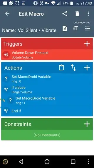

You would need two macros for this
First macro would look like this (Triggers / Actions / Constraints are added by +)
Macro : Vol Silent / Vibrate (name of macro )
Trigger : Volume Button PressedVolume DownUpdate Volume
Actions:
  1. Set MacroDroid VariableNew VariableCreate New Variable→ Give it any name (here ring) and set type to Integer → Set (variable name) → Value = 0
  2. If ClauseConditions +Ringer VolumeVibrate or Silent . Press this If clause and choose Add Child Action. Next, Set Macrodroid Variable, choose the variable name (step 1) and set it to 1
Constraints: No Constraints
Logic: We need to identify when silence or vibrate is reached by Vol Dn . In the first action we named a variable and set it to 0 and in the second action, we set a flag (MacroDroid variable =1 ) to indicate that silence or vibrate is reached. Not specifying any Constraints means we want the macro to always run

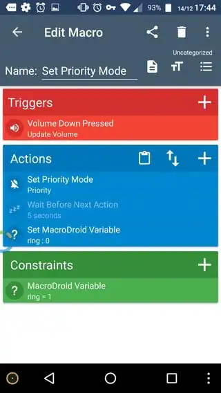

In the next macro, we make sure that if the Volume is further decreased from silence or vibrate state, we set it to Priority Mode. To ensure that it happens only when this state is reached, we use the flag as constraint and re-initialize the variable to 0
Macro : Set Priority Mode (name of macro )
Actions:
  1. Set Priority ModePriority
  2. Set MacroDroid Variable (name you chose, here it is ring) → Value = 0
Constraints: MacroDroid Variable (ring)Value = 1
