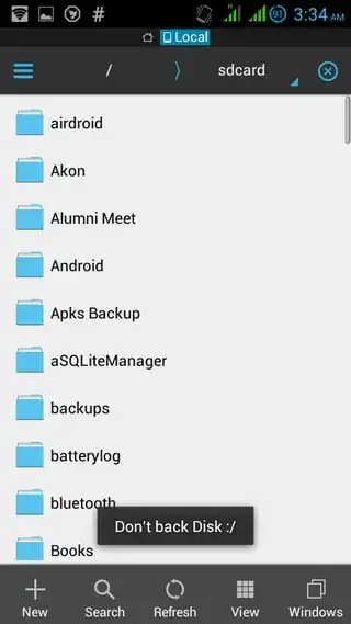

  12. Anyhow, launch ES File Explorer and see the magic. The default screen of this app will show a Toast to you. You open any other activity and it won't bother you. Come back to main screen of it and see the Toast again.
  13. You can have this behavior for multiple apps. Just choose your app in the profile we made in step 3 and 5. They are supposed to be added in OR context like ES File Explorer or BetterBettaryStats and Not BetterBatteryStats or ES File Explorer.

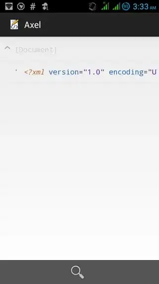

Some screenshots:
(Click any image for its larger variant)
No toast for any other app                     →                Default screen for BetterBatteryStats                  →
(No toast for any other app)                                                (Default screen for BetterBatteryStats)
No toast on dialog on same screen                    →                  Dialog closed and toast came back on main screen                  →
(No toast on dialog on same screen)                                      (Dialog closed and toast came back on main screen)
Toast on Default screen of ES File Explorer                    →                   No toast on dialog of the same screen                  →
(Toast on Default screen of ES File Explorer)                            (No toast on dialog of the same screen)
Toast came back as soon as dialog disappeared
(Toast came back as soon as dialog disappeared)
