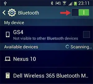

  • To simply put, use a Scene to force-stop and relaunch Bluetooth Share. Btw, can you please be more clear what you mean by "Bluetooth share"? A Pic can say 1000 words! – Abhioxic Jun 13 '15 at 15:19
  • yes, and this is the "Bluetooth (share)" app: http://imgur.com/peB7kV7 – Thomas Vos Jun 13 '15 at 15:29
  • Bluetooth share is not only the sharing part, but the whole bluetooth app. It doesn't crash when I try to share a file, but it occurs randomly. And it is very annoying because I have an Android Wear device. I've got a Samsung Galaxy S4 with Cyanogenmod 12.1 and also look at my question on the Cyanogenmod forum here: http://forum.cyanogenmod.org/topic/110131-cm121-bluetooth-share-randomly-crashesstops-working/ – Thomas Vos Jun 13 '15 at 15:36

  • Ok, now i can understand it clearly
    As it says, its a nightly problem so you cannot fix it. so logcat wont work.
    As you have stated in your post, the only way except rebooting is to clear data and turn on bluetooth.
    Thus, in tasker instead of killing, use data clear and tuning bluetooth on.
    This should work now.
    – Abhioxic Jun 13 '15 at 15:44
