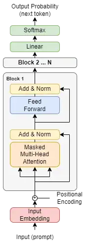

Overview of the (decoder-only) Transformer model
It is key first to understand the input and output of a transformer:
  • The input is a prompt (often referred to as context) fed into the transformer as a whole. There is no recurrence.
  • The output depends on the goal of the model. For GPT models, the output is a probability distribution of the next token/word that comes after the prompt. It outputs one prediction for the complete input.
Next, it is essential to understand the key components that make up the decoder-only transformer architecture:
  1. The embedding: the input of the transformer model is a prompt. This prompt needs to be embedded into something that the model can use.
  2. The block(s): This is the main source of complexity. Each block contains a masked multi-head attention submodule, a feedforward network, and several layer normalization operations. Blocks are put in sequence to make the model deeper.
  3. The output: the output of the last block is fed through one more linear layer to obtain the final output of the model (a classification, a next word/token etc.)
The following visualization gives an overview of the transformer architecture.
Overview of transformer architecture
Self-Attention Mechanism

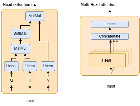

Self-attention makes the transformer powerful. The intuition of self-attention is that the mechanism allows the model to focus on (attend to) the most relevant parts of the input. A single self-attention mechanism is called a head.
The head works as follows. First, the input is fed into three separate linear layers. Two of those (the queries Q and the keys K) are multiplied, scaled, and turned into a probability distribution using a softmax activation function. Think of this probability distribution as describing which indices matter most for the output (i.e. which words in the prompt matter for the next word to be predicted). Finally, the output is multiplied with values V. This thus gives V * the importance of each of the tokens in V. A key observation is that the learnable parameters in the head are the three linear layers.
The following figure gives an overview of the operations done in a head and an overview of how multi-head attention works.
Overview of attention mechanism
Multi-Head Attention
Multi-head attention is nothing more than several individual heads stacked on top of one another. The input to all heads is equivalent. However, each head has its own weights. After forwarding the input through all the heads, the output of the heads is concatenated and passed through a linear layer which brings the dimensionality back to the dimension of the initial input.

Block
Each block contains a multi-head attention submodule, a feedforward network, 2 layer-normalization operations, and 2 skip connections.
The feedforward network is simply a multi-layer perceptron. In the original paper, the proposed feedforward module consisted of (1) a fully connected layer; (2) a ReLU activation; (3) another fully connected layer; and (4) a dropout layer.
The 'add & norm' blocks get the output from the multi-head attention/feedforward submodule and add it to the input into those modules. After that, a layer normalization operation is performed. Adding the input and output of a submodule together is known as a skip-connection. As blocks can be put in sequence, the skip connections help tremendously reduce the problem of vanishing or exploding gradients. In other words, skip connections are necessary to ensure proper backpropagation of the gradients.
