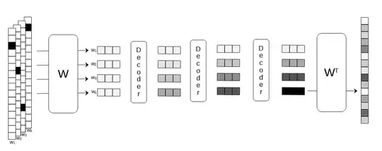

The general picture I have learned goes like this:
  1. One-hot word vectors are sent through the embedding matrix $W$ and yield lower-dimensional word embeddings.
  2. In each decoder layer the word vectors are enriched by the attention mechanism, but only by contextual information from previous tokens ("masked attention").
  3. So the first token doesn't get enriched at all, its information content remains the same.
  4. The last token takes up the maximum of information available and after the last decoder represents the context as a whole.
  5. It's only the enriched word embedding (= context embedding) of the last token that is now sent through the transpose $W^T$ of the word embedding matrix (the final decoder, different from the transformer decoders). It yields the logits vector.
Other models than GPT may use other final decoders than $W^T$.
The following diagram depicts this. The shades of gray of the word vectors passed through the transformer decoders display their informational content (or density).
Hans-Peter Stricker
  • 891
