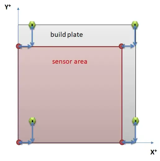

1. Sensor at the back-right:
Probe area for back-right probe
This implies that the sensor can reach the back and the right borders, so the limits are set by:
#define LEFT_PROBE_BED_POSITION (X_PROBE_OFFSET_FROM_EXTRUDER)
#define RIGHT_PROBE_BED_POSITION (X_BED_SIZE)
#define FRONT_PROBE_BED_POSITION (Y_PROBE_OFFSET_FROM_EXTRUDER)
#define BACK_PROBE_BED_POSITION (Y_BED_SIZE)

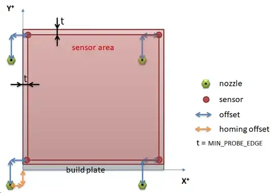

Note that if a minimum probe offset is defined by #define MIN_PROBE_EDGE [value] in the configuration (to account for sensor width/dimension), the bed limits are changed resulting in (where t = MIN_PROBE_EDGE):
Probe area for back-right probe with MIN_PROBE_EDGE offset
Limits are then set by:
#define LEFT_PROBE_BED_POSITION (X_PROBE_OFFSET_FROM_EXTRUDER + MIN_PROBE_EDGE)
#define RIGHT_PROBE_BED_POSITION (X_BED_SIZE - MIN_PROBE_EDGE)
#define FRONT_PROBE_BED_POSITION (Y_PROBE_OFFSET_FROM_EXTRUDER + MIN_PROBE_EDGE)
#define BACK_PROBE_BED_POSITION (Y_BED_SIZE - MIN_PROBE_EDGE)
In the following sensor position placements, this offset for MIN_PROBE_EDGE will be accounted for.

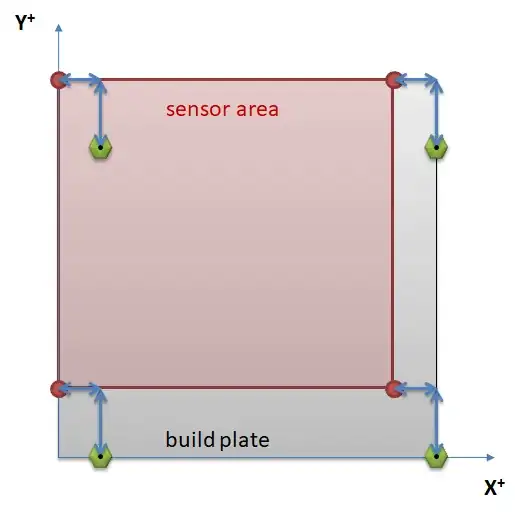

2. Sensor at the back-left:
Probe area for back-left probe
This implies that the sensor can reach the back and the left borders (for zero MIN_PROBE_EDGE), so the limits are set by:
#define LEFT_PROBE_BED_POSITION (MIN_PROBE_EDGE)
#define RIGHT_PROBE_BED_POSITION (X_BED_SIZE  + X_PROBE_OFFSET_FROM_EXTRUDER - MIN_PROBE_EDGE)

4. Sensor at the front-right:
This implies that the sensor can reach the front and the right borders (for zero MIN_PROBE_EDGE), so the limits are set by:
#define FRONT_PROBE_BED_POSITION (MIN_PROBE_EDGE)
#define BACK_PROBE_BED_POSITION (Y_BED_SIZE + Y_PROBE_OFFSET_FROM_EXTRUDER - MIN_PROBE_EDGE)
This should have tackled the basics for defining the sensor area limits. It becomes a little more complicated when there is extra travel space. A very easy use of extra travel space can be found in the configuration file; e.g:
// Travel limits (mm) after homing, corresponding to endstop positions.
#define X_MIN_POS [XX]
#define Y_MIN_POS [YY]
where [XX] and [YY] are offset values from endstop to origin (orange arrows represent X_MIN_POS and Y_MIN_POS):
Probe area for back-right probe including homing endstop offsets Results in offset constants for a back-right probe:
#define LEFT_PROBE_BED_POSITION (X_PROBE_OFFSET_FROM_EXTRUDER + X_MIN_POS + MIN_PROBE_EDGE)
#define FRONT_PROBE_BED_POSITION (Y_PROBE_OFFSET_FROM_EXTRUDER + Y_MIN_POS + MIN_PROBE_EDGE)
For all other options, a similar addition of the homing offsets can applied.
