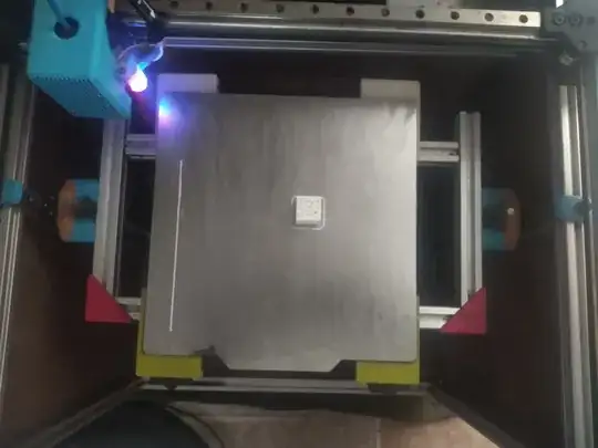

I have a BLV Core XY, I'm trying to print different models, but the machine moves the center once it goes to start the process.
This is my G-code of the beginning:

However, if I do a simple command like, to send the (0,0) on Z axis, it happens fine.
center
0scar
  • 35,554
  • 65
  • 151
You have defined your bed incorrectly in the firmware.
First line you print is at X=2, while it is printed a couple of centimeters from the edge. Second the final cube is not in the center of the bed while it presumably is sliced in the center.
You should look into the definition of the bed size, the end stop offsets and the probe offsets to fix this. A detailed question and answer is found in How to set Z-probe boundary limits in firmware when using automatic bed leveling?.
