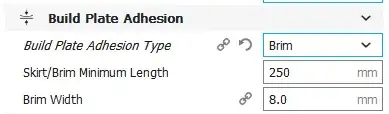

The lazy way: Skirt/Brim
With my TronXY X1 I learned pretty fast, that this first bit of extrusion on an unheated bed can totally mess up the first layer by being just in the way, as explained in the question.
To some degree, this behavior can be avoided by adding a skirt of a certain length. An equally good alternative that also increases bed adhesion for tricky parts is the brim. Both are not set via G-code but can be added by the slicer. In Ultimaker Cura both are found in the tab Build Plate Adhesion as type, as the following pictures show:
Skirt: 2 lines, minimum length 250mm
Brim: minimum length 250mm, 8mm width
