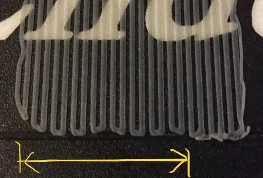

I started using rafts more often, to get better results with complex or fragile parts, but my Ender 3 consistently under-extrudes the initial outside line of the raft (for the first inch or two, where extrusion starts).
It is often very thin and does not adhere. This often leads to problems with the following pattern of raft layer 1 curling up (ABS) as it does not meet the edge line (due to the 1-2 inch gap in the perimeter).
Skirts avoid this problem by getting the flow going, but rafts only print a single outer line.

example of problem

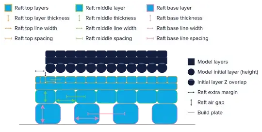

There is no option available in Ultimaker Cura to increase the outline count of the raft bed adhesion structure. Basically the raft exists of a line support structure as can be seen in the figure below. Ultimaker raft support structure layout The line around the lines should be considered "the skirt", so if the nozzle is not properly primed (not sufficient molten filament available), you need to properly prime the nozzle prior to printing.
