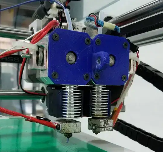

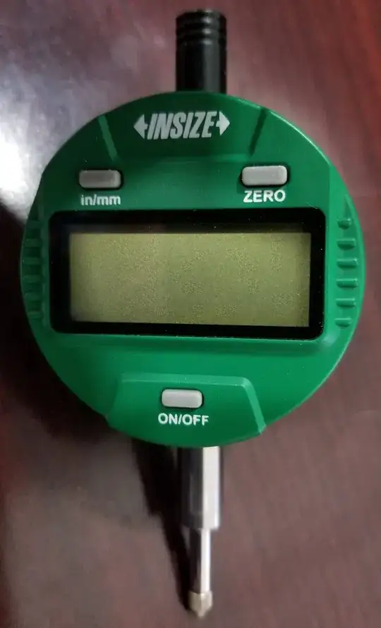

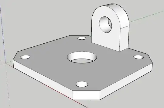

I printed a faceplate for a Reprap X400 to use an electronic drop gage to level the bed: faceplate extruders back of gauge front of gauge
