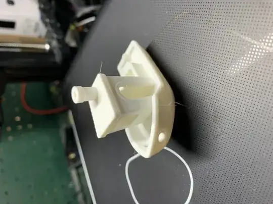

I'm using Overture Brand white PLA and for the first print that messed up (pic below), I was using the default "generic PLA" Cura settings for an Ender 3 pro.
The problem:
Anyhow, it caused this kind of print:
3D benchy with printing errors
There are a few angles where it actually looks pretty good. The hull is fairly smooth, the first layer went down well, the roofs and bridging look tolerable, but as you can see, especially around the "pillars" it looks I don't know... under-extruded? Like the lines don't connect very strongly. In fact, it might be hard to tell from this photo but the bottom actually ripped off when I took it off the plate, mostly due to weak connections between each layer.

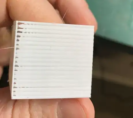

  • I did the baseline print. My first one looked like the top of the cube had some under extrusion (you can see through it if you look closely in this photo enter image description here
  • I did the slicer flow calibration and actually it came out a little tiny bit too big (which would indicate I need to turn down the flow), but as Teaching Tech mentioned at the bottom of the page, you can't always trust that so I didn't end up making any changes to flow.
    • Worth pointing out, in this photo of the Slicer Flow calibration cube, you can see some weird holes where the nozzle would be kinda late starting a line. enter image description here

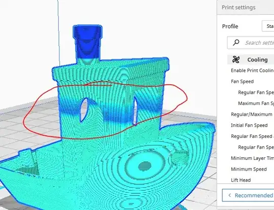

One other strange thing I've noticed is the benchy always looks bad in the same spot (the pillars). Makes me wonder WHY it's always that exact spot, not randomly all over.
It's got to have something to do with under-extrusion or flow. I think I ruled out the Z-axis. I made a "tall" benchy by modifying the benchy file to have a platform underneath it. This bumped it up a few cm and the problem still happened in the same spot on the pillars of the benchy (which is now in a completely different spot on the Z. Also, given the "flow" preview in Cura: enter image description here
That circled low flow area is where it always messes up.
So now to figure out why it's got low flow. Again, I calibrated the E-steps and it seems to be accurate. I've also printed benchy's where I told Cura to have 110% flow just to check. The last one I attempted didn't just fail, it failed big time and became a blob at that same spot.

    Next time forget the [bubble level](https://3dprinting.stackexchange.com/a/7892)! ;-) Level the printer to the printer axes, not to [gravity](https://3dprinting.stackexchange.com/q/470)! You clearly have an under-extrusion problem, I wonder how the 100 mm is being determined. If in free air, this may be quite different from "at height" which might add more backpressure causing you extruder to skip. – 0scar Nov 22 '21 at 18:44

    If [this](https://www.thingiverse.com/thing:1278865) is your reference for a calibration cube, please read [my comment](https://www.thingiverse.com/thing:1278865/comments#comment-3405161). You're spot on with the cube makers ;-) , but as in that comment, that image is not correct. What strikes me is the re-occurring pattern like it is in sync with the threaded rods pitch? Maybe you could decouple the spool and feed the extruder a pre-cut length + 1 m of what you would need for the cube, print the cube and measure what is left minus 1 m and compare that to the calculated by the slicer. – 0scar Nov 24 '21 at 09:09
enter image description here It was a worn extruder gear. I didn’t think it was THAT worn, and when I loosened it a bit and slid it a few mm so that the gear hit the filament in a fresh spot it didn’t improve. But new stainless steel gears showed up today and when I installed one it worked perfect. Same file/settings/gcode that had failed several times previously when testing other things
