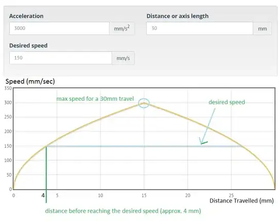

A tool that you might find useful for experimenting with acceleration is RepRap Centrals Acceleration Calculator (at the bottom).
By setting an acceleration, length of travel and target speed, you can see:
  1. The theoretical speed that can be achieved during the travel with your set acceleration (yellow line).
  2. The distance required to reach your target speed, and for how long it will hold that speed before slowing down (blue line).
For instance, setting acceleration = 3000, length = 30 and speed = 150 means it will travel 4 mm before reaching its desired speed of 150 mm/s, while that same acceleration theoretically could give a speed of 300 mm/s for the given distance:
Calculating speed, acceleration and jerk:

    I do not completely understand how you get to the number of 'somewhat less than 5 seconds'. The calculator should show length on the x-axis and the acceleration could theoretically give a speed of 300 mm/s, on a length of 30 mm as given by you while taking into account that the printer has to accelerate and deaccelerate by the given 3000 mm/s^2. Do I see this correctly? Otherwise excellent answer! – kamuro Jan 04 '17 at 11:25
  • @kamuro, excellent question! I added an image where I have highlighted the info. Notice where the green line intersects the x-axis (at approximately 4 seconds). :-) – Tormod Haugene Jan 05 '17 at 08:59
    But it cannot be coincidence that the x-axis of the graph scales with field 'distance or axis length', can it? – kamuro Jan 05 '17 at 14:03
  • @kamuro, I think you are absolutely right. The x-axis has to be the distance travelled, and not the time. Then, the green line would mean it takes 4 **mm** to reach the desired speed, and not seconds. Now that I think about it, 4 seconds is a tremendously long time for a stepper motor to speed up. :-) I have updated the image/explanation. – Tormod Haugene Jan 05 '17 at 15:13
