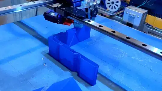

The firmware I use provides this model to test ringing:
Would that be suitable to stress-test the skipping of steps or should I consider making my own, and if, what features should it have?
