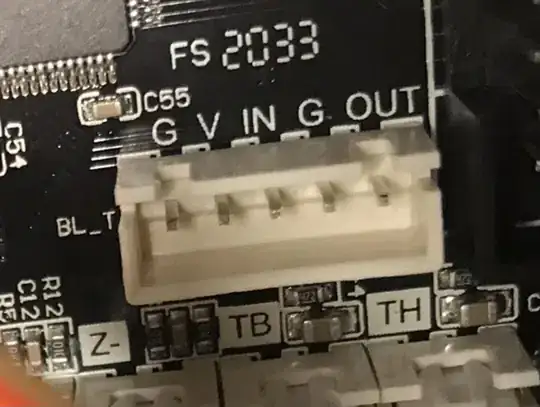

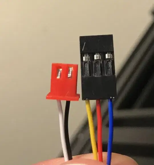

I'm using 3D4LYF's wiring scheme as I'm using the same set up I believe he is using. The two wires (white & black) on the red connector go in the Z-axis endstop port on the mainboard. For the three wires on the black connector I have: blue=Ground, red=V, yellow=IN that goes in the other 5 pin port on the mainboard. I rearranged the wiring from red/blue/yellow to blue/red/yellow as suggested by 3D4LYF again because I am using the BLTouch Creality Kit. Adding photos of 5-pin port and the connectors:

  • @0scar > BL Touch wiring used : Using 3D4LYF's wiring scheme as I'm using his same set up I believe : For the two wires (white & black) on the red connector that goes in the Z-axis end stop port on the mainboard. For the three wires on the black connector I have blue=Ground, red=V, yellow=IN that goes in the other 5 pin port on the mainboard. I rearranged the wiring from red/blue/yellow to blue/red/yellow as suggested by 3D4LYF again because I am using the BL Touch Creality Kit. Adding photos of wiring and 5-pin port above. – wallwalker Mar 07 '21 at 15:15

  • Please don't link to photos externally, SE has their own Imgur photo server which retains the photos as long as SE sites exist. I've added the images for you. Is it a genuine BLTouch? I don't think so, I've read the fake ones give problems on this board. – 0scar Mar 07 '21 at 21:23
Resolved : connected the white & black wires to the 5 pin output on the board. This solved the homing issue.

I had the same issue and thought I bricked it, so thank you for getting me on the right path! For Ender 3 Pro v4.2.2 motherboard, no Pinboard A, ISP Pinboard, or Burner required! In my case, I had used the provided pins (white housing) that were on the v4.2.2 motherboard itself.
In doing so I had to switch the positions of the red and blue wires in the 3-pin connector (glad I pay attention to those types of things), connected white and black connectors right beside it as the OP has figured out (the connector my BLTouch came with was a little big so I had to cut a wall of the white housing a little; it fits really well), and re-connected the original Z-axis cable (did not need to remove to start with, but still unused as the BLT pretty much replaces it).
