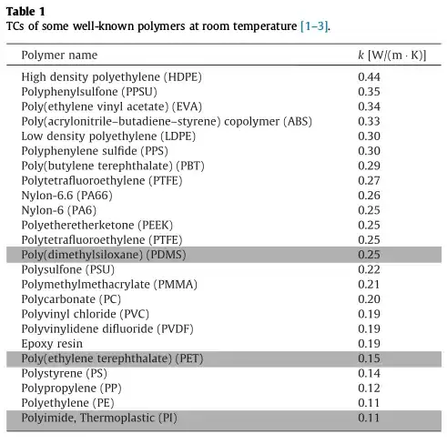

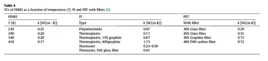

    what is the source of Table 1 and 4? – Trish Sep 19 '19 at 15:24
  • Do you have a source for the amazing performance of TCPoly that's not their marketing materials? :-) – R.. GitHub STOP HELPING ICE Sep 19 '19 at 22:14
  • I'm sorry I havent provided the source for the tables yet. I meant to originally, it just slipped my mind. It's a review of thermoplastic polymers that I havent been able to refind. – K Mmmm Sep 20 '19 at 02:47

  • Just pointing out that the list in the answer does not directly correspond to the table images provided. PETG (polyethene terephthalate) with 40% Carbon fibre is not the same material as PI (polyimide) even if the thermal conductances might seem similar between the list 1.7 and table 4, 1.73. Also, TCPoly's **filaments** at best are around 8 W/mK once you actually read their specs, and the thermal conductivity varies per plane extrusion direction. The alleged value of 15 W/mK is given for their proprietary print services. – dquintero Apr 15 '20 at 02:24
  • Also, I did not find a reference to his k value for PLA with copper in the 3DHubs link provided. Basically, the values provided in his answer could be right, but they are certainly not justified with the sources provided. That said, this information is not simple to find at least for commercial filaments. – dquintero Apr 15 '20 at 02:24
