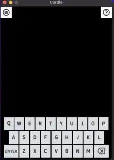

The problem arises when I am trying to use the Global Python 3.8.9 interpreter (usr/bin/python3). When the code runs, the application ends up looking like this.
not working tkinter
Additionally, when I run the code the terminal reads the following:
DEPRECATION WARNING: The system version of Tk is deprecated and may be removed in a future release. Please don't rely on it. Set TK_SILENCE_DEPRECATION=1 to suppress this warning.

One last thing, when I get rid of all mentions of the package Tkmacosx, the app appears like this:
app without tkmacosx
