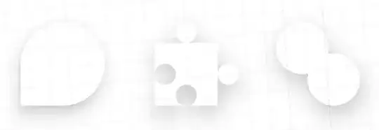

Screenshot of ClippedShadow() with various Shapes made from irregular Paths.

Screenshot of ClippedShadowFloatingActionButton, ClippedShadowButton, and ColoredShadowFloatingActionButton examples
