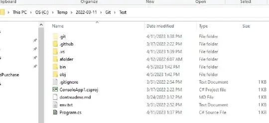

Remotely try this:
  git push -d origin <Branch-Name>
Locally:
git branch -D <Branch-Name>
EDIT:
Don´t know why my negative vote. My answer works:
