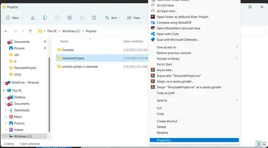

Make sure you open the command line prompt as admin. Then, make sure project files are not read-only.
In windows, you can check this by right-clicking on project folder -> click "Show more options" -> click "Properties" -> deselect "Read-only" -> click "Apply"
Onat Korucu
