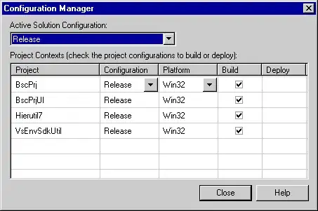

You can uncheck the build option for specified projects in your Solution configuration:
SolutionProperties
(source: microsoft.com)
You can can create your own solution configurations to build specific project configurations...
build config

  • I would still like the project to build if it has changed. This will not build the project if it has changed. Thanks though! – Brad Leach Feb 20 '09 at 01:15
