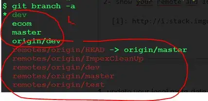

1- update your local meta-data using : git fetch --all
2- show your remote and local branches using : git branch -a , see the following Screenshot
3- switch to target branch , that you want to linked with the remote: using
git checkout branchName
example :
4- Link your local branch to a remote branch using:
git branch --set-upstream-to nameOfRemoteBranch
N.B : nameOfRemoteBranch : to copy from the output of step 2 " git branch -r "
Example of use:
