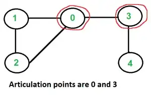

articulation points
Since we're on a grid and all districts must be continuous, we can just consider the immediate neighbours of a point to determine whether it's an articulation point. If you can't see this, it's not super important, you can use the algorithm that works in general on a graph. I found the grid version easier because it involves no recursion.
See the is_swappable function if you're interested. This is what the "Randomly evolve" button in the demo does.

  Return whether a point can be removed from a district without creating disjoint districts.
  In graph theory, points that cannot be removed are articulation points.
  For a general algorithm, see: https://stackoverflow.com/questions/15873153/explanation-of-algorithm-for-finding-articulation-points-or-cut-vertices-of-a-gr
  My version takes advantage of the fact that we're on a grid and that all the districts must be continuous,
  so we can consider only the immediate neighbours of a point.
