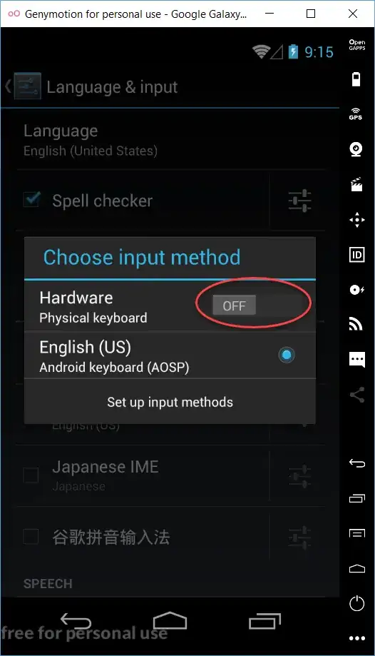

After trying every individual answer here the keyboard doesn't show up.. I got hours to get this solved, so hope someone doesn't waste it in the future..
For my case, the issue was not a programming issue at at, I was testing on an emulator with a phone that has a hardware keyboard, so it doesn't show up the software keyboard by default, to solve this, you need to make sure that the show soft input enabled in your emulator by turning off the hardware keyboard or enable the soft keyboard.
In faced this only on API-15 & 16. Here are screen shots how to do that
On Geny Motion emulator:
On Android Studio emulator:
Zain
  • 37,492
  • 60
  • 84
