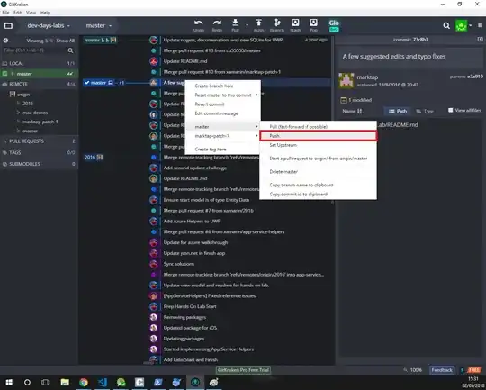

12
In GitKraken you can do this:
  1. Right click on the commit that you want to reset, choose: Reset to this commit/Hard:
    Enter image description here
  2. Right click on the commit again, choose: Current branch name/Push:
  3. Click on the Force Push:
Obs.: You need to be careful, because all the commit history after the hard reset are lost and this action is irreversible. You need to be sure what you doing.
