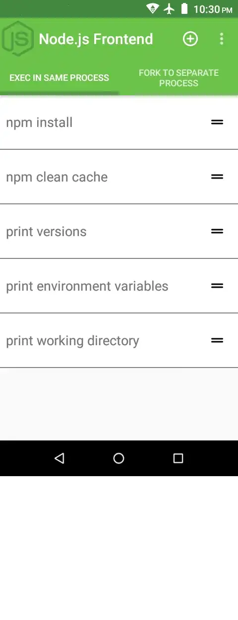

Node.js Frontend for Android
  • releases include signed apks
  • Android 4.4+
  • open source (GPLv2)
  • no root
  • frontend for Node.js for Mobile Apps by Janea Systems
    • which was announced earlier in this thread by one of its developers
    • which is a game-changer; great work!
  • at a high level:
    • the "exec in same process" tab:
      • includes a list of Node.js apps that are intended to run for a short period of time while the application remains open, and may only be executed one at a time
    • the "fork to separate process" tab:
      • includes a list of Node.js apps that are each executed in a separate foreground service in a distinct process, and are intended to hold long-running daemons (ex: various types of servers)
